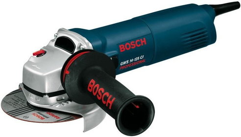

Post: ndz lut 07, 2016 9:33 pm
[oczko]
c4df5c26e2201d2c4a10bca3cfbe093b.jpg [ 20.6 KiB | Przejrzano 6902 razy ]
